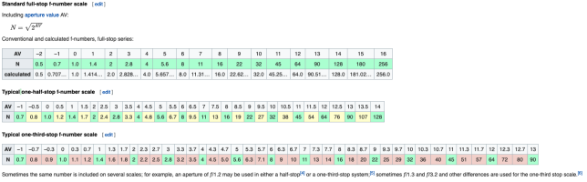

No, it’s exactly one full stop.
f/1.8 to f/1.2 is about two-thirds of a stop (f/1.8 to f/1.4) plus half a stop (f/1.4 to f/1.2), ie the difference is about one and one-sixth stops. The f-stop series is not linear so it's not exactly one and one-sixth stops, but it's in that ball park. It's definitely more than one stop.
Depends on which scale you are using and what your camera supports. My film A-1 and FD lenses supported one-third stop ISO and exposure compensation values on the body, but one-half stop apertures in the lenses and Av values on the body. The exposure compensation was simply an adjustment to the ISO setting for the film. My 1DX2 lets me set 1/3 stop or 1 stop increments for ISO speeds, and 1/3 stop, 1/2 stop, or 1 stop increments for exposure and exposure compensation.
On the one-third stop scale, the difference between f/1.8 and f/1.2 is a full stop, f 1/8 to f1.4 is 2/3 stop and f1/4 to f1.2 is 1/3 stop. You would dial in a full stop of exposure compensation between the two values. This would be the same anywhere on the scale.
On the one-half stop scale you'll see different AVs for the same f/stops, f/1.2 is 0.5 versus 0.7. There is no 1.8 so you'd be forced to choose between 1.7 and 2.0.
from https://en.wikipedia.org/wiki/F-number

Here's a table of the numbers from the computation with 2 decimal digits for both 1/2 and 1/3 stops with N representing the f-numbers. The actual numbers are somewhat different than what you see display with 1 decimal digit. This convention has been around a long time.
It doesn’t matter what scale you use. There are 1.25 stops between f/1.2 and f/1.8.
Shooting the same greycard with 1/3 or 1/2 setting gives one stop difference in any case between f1.2 and f1.8, so for all intended purposes, there is no more and no less than one stop betweeen them. If you’re going to use a lens on a camera, one stop is the difference.

The markings displayed on the camera or lens are approximate to minimize the space they require and make it easier for us to communicate. The actual lens mechanism and metering uses the more precise increments that are equally spaced in 1/2 or 1/3 stop increments. When your camera is set to 1/3 stop exposure increments and you change the aperture in Av mode, it is 3 steps from 1.2 to 1.8 or 1 stop. This is true throughout the entire range.
You can use the formula f-stop-difference = log(f1/f2) / log(sqrt(2)) for any two f-stops f1 and f2. Using the approximate values gives log(1.8/1.2) / log(sqrt(2)) = 1.17 (1.1699) while the precise measures give log(1.78/1.26) = 1.00 (0.9969).
