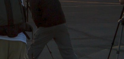

Keith, those are some nice images but I'm gonna be tough on you here. Even to my old eyes the shadow tones in the mustang shot look full of canon chroma noise and stripes. Not in this little dinky downscaled shot within this thread, but the 2 & 3MP "large" version available on flikr.
And they are, you don't even have to push anything to see it, just look between the 2 photog's on the R side.
Sorry, tools like that do not meet my standards of image quality, not when they come with that kind of price tag.
If you're happy with them, great. But image quality like this is the reason I dumped Canon and went to ABC cameras.
Most people likely would not notice the noise, I sure do, much as I listen to the silence between the music.
A crop and 2x linear with some gamma shift to make it obvious for those who can't see it in the original.
Maybe I'm just getting spoiled looking at super clean ABC shadow tones for the last couple years, this now jumps out at me in some shots.
