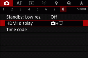

How do you have the HDMI menu setup
  • I run like this:
  • Means I can not trigger internal recording but you will also notice no thermal protection timer is displayed
