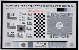

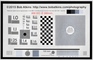

The-Digital-Picture does nice IQ tests with charts but they are all at different distances so that the image fills the frame. I want to know how different telephotos perform and resolve details on a chart at a fixed distance away. Here is a collection of tests I have done for various lenses on the R5. The chart, courtesy of Bob Atkins, is only 13.6cm across, about the size of a small bird. The numbers on it are line pairs per mm. The distance was 20m, which means tests were performed outside in natural light that varied over time. I also used a standard laser printer for the chart and so the lines are not at high resolution - irregularities can be detected at pixel level peeping. Even so, you can get a good idea of how the lenses and extenders perform.

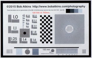

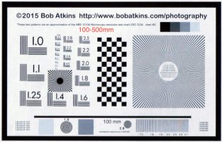

First, the RF 100-500mm on the R5. The bare lens at 500mm cannot resolve the 2.8 lp/mm rings. Adding the RF 1.4x TCs increases the resolution to resolve those rings, and the RF 2x at 1000mm even better resolution, an increase of 40% over the bare lens.
309A4700-DxO__Chart_20m_500mm_centre_marked.jpg309A5458-DxO__Chart_20m_700mm_centre_marked.jpg309A5483-DxO__Chart_20m_1000mm_centre_marked.jpg

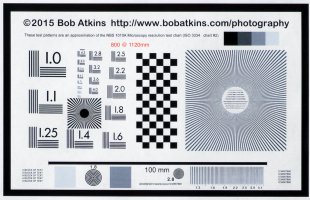

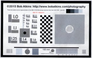

The RF 800mm has a nice jump in resolution on adding the RF 1.4x and an incremental increase with the 2x. At 800mm, it is better than the 100-500mm at 700mm, and close to to the 100-500mm at 1000mm.
309A5375-DxO__Chart_20m_1120mm_centre_marked.jpg309A5399-DxO__Chart_20m_1600mm_centre_marked.jpg

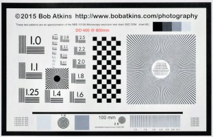

For comparison is the EF 400mm DO II. The bare lens is outresolved by the 100-500mm. Adding the EF 1.4xTCIII to give 560mm leads to it outresolving the bare 100-500mm but is behind the lens at 700mm with the RF 1.4xT. The EF 2xTCIII at 800mm and f/8 is very similar to the RF 800mm f/11 in resolution. Stopping the lens down to f/11 (not shown) increases resolution a bit and draws slightly ahead of the RF 800mm f/11.
309A7347-DxO__Chart_20m_DO_400mm_centre_marked.jpg309A7442-DxO__Chart_20m_DO_560mm_centre_marked.jpg309A7403-DxO__Chart_20m_DO_800mm_centre_marked.jpg
My bird photos in the field bear out these results, both at far and close distances. Even though I'll never use it much, I am keeping for the time being the RF 800mm for occasional us at 1120mm as it really extracts a lot of detail. I hope these charts are of so use.
