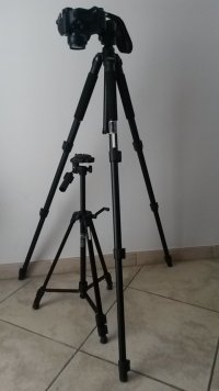

This is an image of the set up I mentioned earlier.
The "wind up" handle on the smaller tripod works well in small increments to aid focus, I imagine you could stack the images!
I have a 8" square of foam board that sits on top of the small tripod, this acts as the platform to sit the objects to be photographed.
Hope it helps ???
