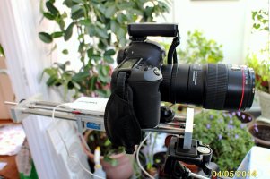

lion rock said:I built a focus rail and shot about 20 frames but the result that came out processed with PS CS5 was incorrect. PS chose all the OOF frames and thus what I got was a 100% blurry photo.
My question to the experts here, when you use a rail to select a focus plane, will the image in front of the selected plane be slightly larger because the camera/lens is closer and the image behind the selected plane be smaller, so as you change positions during the process, what would happen to the stacked end product photo?
Conversely, if the camera/lens is held stationary, and the focus is selected by adjusting the lens focusing mechanism, what will be the result?
My setup: 5D3 with remote flash mounted on hot shoe, 100 mm_f/2.8 with Kenko extension ring, and the camera is controlled with CamRanger all mounted with a screw operated rail.
Thanks for the advice.
-r

Menace said:lion rock said:I built a focus rail and shot about 20 frames but the result that came out processed with PS CS5 was incorrect. PS chose all the OOF frames and thus what I got was a 100% blurry photo.
-r
Personally, when focus stacking, I never change the frame i.e. camera never moves. Here is my very basic MO
1. Fix camera on tripod
2. Frame your subject - use live view.
3. Manually focus and shoot a bunch of images - each focusing on a different plane of your subject. Use remote etc.
4. Process in PS.
Hope this helps
