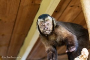

So here are my examples. Shot in similar conditions. Poor light. Low contrast. Both with minor PP to get correct exposure(pushed by a bit over a stop each) exported through LR with default NR(20 colour, zero luminance). R5 at 4000. 7d2 at 1250. Compare the pair(1).jpg(1)-2.jpg
Sorry. I did forget to mention that the 7d2 image was cropped. Fro's shot was not. Here is the uncropped version(1)-3.jpg
I’m not sure, but looks like maybe the same if I discount the larger noise blobs on the crop sensor shot. Looks better than how my R does against the R5.

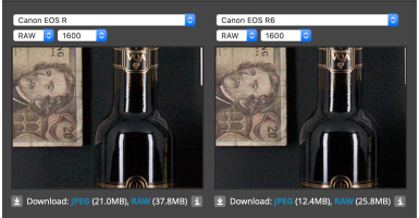

Here is the R6 compared to the R
You were 100% wrong.

From what I've seen, the EOS R6 (or 1DX III, they look pretty similar of course) is not a whole lot better than the EOS R in terms of noise, maybe less than half a stop in it.
The difference starts to be a bit more noticeable at 12800 or 25600.
For 4k video ISO, I expect it to gain another stop since it is almost a full sensor 1.07x as opposed to a 1.75x crop, and maybe the newer processing helps as well, so it might be almost two stops better.
On the other hand, I also checked the resolution, which is really not that different either, the R6 is very nearly as sharp as the R except in some cases there is probably more moiré, due to the pixel count and weak AA filter.
So the EOS R sensor is still good, but the worries about 20MP vs 30MP are also unfounded.
I guess the dynamic range is also going to be a bit better on the R6, but I couldn't check that one out yet.
Main line is that the sensor is (also) great in the R6 (but it's not groundbreaking).

R6 sensor lab test is up at DPR. It is as good as 1Dx3 at ISO6400 and it is not much better than 5D4 or R at ISO6400. People get emotional. Sure. Let’s look at a reliable data instead.
