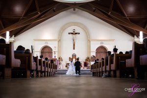

I often shoot without looking through the view finder. I do both ground shots and overhead shots this way. The shot below was taken this weekend with the camera sitting on the floor. I set the focus point using liveview and then pressed the shutter release.
