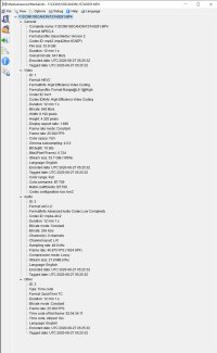

I just did a test with 8k25 with clog, to UHS II, no IS, rf 35mm, rear screen closed inwards.
1st test, 19mins 56s. Roughly the same as I got before (20m 10s)
Then I sat it on my tripod, next to the air con unit (which is near the ceiling - lucky my tripod will extend to over 2m). Based on Gordon's video where Canon said ok for the freezer, I thought air con would be ok - but I am not sure I would do this for extended recording / cooling.
Removed battery but kept everything closed bar the screen. Left the lens on as I figured it was slightly warm and thus provide some cooling. Also had an L bracket on, but slightly extended - also to perhaps provide some cooling. Air con on about 15mins, 18 deg. Body felt suitably chilled :D
The temp in my appt is not 18 deg atm, but for the 2nd test it is fair to say it was cooler than the first. When I tried previously with a desk fan and not using the air con on max, it still took me the 2 hrs to cool it down before I got the max record back.
Display shows 15 mins recording time, same as before ie fully restored. Hit the record button. 26mins before it ran out of space :LOL:. The overheat warning icon was on and didnt allow further recording. I guess I overdid it a little on the air con.:LOL:

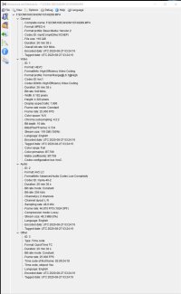

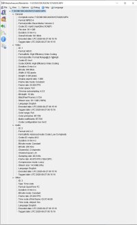

I uploaded these pics from the iphone (FW Test 3-1, 3-2 and 3-3) with no editing, no cropping, no downsizing just in case someone would feel that I might somehow cheat...
Summary:
1st Test from power up (off all night) 19mins 56s
Next to air con unit for 15 mins.
2nd Test (indoors) 26m (ran out of storage, and then would not record further)
Cool down with 5" Fan for 15mins
3rd Test Outside on Balcony 18mins 31secs.
Cool down with 5" fan on Balcony. After 20mins it stated 5 mins. After a futher 10 mins still 5 mins.
4th Test Outside on Balcony 12mins 1s
Cool down by itself. After 20 mins it says 4 mins available and it feels midly warm. After a further 10 it tells me 5 mins.
5th Test (final) outside on Balcony 8mins 4s
Conclusions (mine!)
Indoors, with a 5" USB fan and some form of env temp control, then I think the recovery time has decreased a lot. For me, 2hrs down to 20 mins.
Outdoors, same fan, it gave me around 50% more recording time for the same cooldown period.
