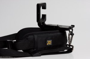

The photo below shows how I have been using my BR and L-bracket for over a year - super solid as the Ty-Rap has a metal locking pin inside. I love the setup and may try to loop the E1 onto the Ty-Rap too. I also really like the idea of the Kirk 1" clamp. Is this the one you use?

I have battery grips on both bodies, and the grip provides the lower attachment point for the strap.
Yes, that's the Kirk clamp I use (I chose it over the small RRS clamp because the latter has little nubs on the bottom where the FastenR-3 goes). I attached the FastenR-3 to the Kirk clamp with a bit of Loctite Blue on the threads. I do have a spare FastenR-3, but haven't had any need to use it - the Kirk clamp makes it so easy to change where I attach the BR strap.
