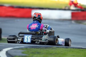

I have already posted the Kart going 40+ - I think that answers that question
Not really. It's a great shot, but you're panning to follow the car. I've had plenty of success doing that with manual focus lenses, so to me it says very little about AF capability. Stand at a curve in the track and use your 5DII to shoot an AI Servo burst of the car approaching you at 40+, then show me the keepers from that...
I think it was you that said that it followed well going across the frame - and there is the shot that proves it.
You will find motorsport shooters always take the photos from the side as it gives the impression of speed, so sorry a head on shot is not going to be available.

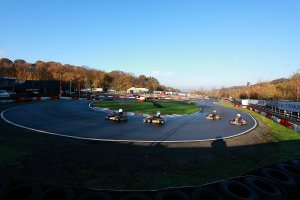

Kart tracks are tight and twisty and this shot was on the exit from a corner. Not really possible to pan on the angle using manual focus. Here is the exit of the corner from the entrance side - the other shot was taken from trackside of the exit of the corner. I was tracking all through the corner on servo.
(this shot was taken with the 1D4 - just here to show you where the other shot was taken coming out the corner rather than along a long straight)

This is the only wa photo of the track that gives a better view of where the kart was (sorry about the quality) - showing how I had taken it coming stright on and kept it locked in focus. Look for the RENAULT boarding on the right which is behind the kart in the first picture. For the first picture I was standing by the first pole and took the picture as it was past the apex (just moving away from me) To get that picture it is clear that the AF was locked on through the corner when the kart was coming straight on to me.
I think that answers the question about the AF locking on with real evidence.
It was, but it doesn't. It wasn't the 5DII's AF that was tracking the car, it was you panning the camera, as the background blur attests. That shot very clearly demonstrates your skill as a photographer, but doesn't demonstrate effectiveness (or lack thereof) of the 5DII's AF system.
