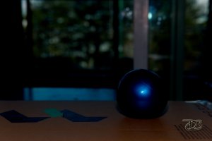

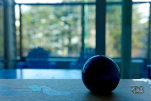

I don't have a 600EXT but a version 1 580XT... and an R5.. I can try some stuff if you have some specific settings. I'm curious too.
normally when I run and gun I don't use manual, on flash, but on camera.. with fixed aperture and shutter speed and ISO variable. Then I put the flash on high speed sync and the expose on it at -1 EV.. or - 1/2.. on my 80D it worked fine, but haven't tried on R5.. .probably should get around to it.
did a quick test.. all images backlit badly (on purpose) with manual settings, eval metering, 1/500th F6.3 and auto ISO.
Shot #1 no flash auto ISO was 1000.
Shot #2 flash pointed up at high speed sync, EV -1 auto ISO detect 1000
Shot #3 flash pointed forward, high speed sync, EV -1 auto ISO detected 100
Shot #4 flash pointed up, high speed sync, EV 0 auto ISO detected 1000
think the last is what you more or less want.

Thanks for the quick response. I'm not actually using a 600 either but a Godox AD360ii but didn't want to get into an it's the vendor's fault conversation. My Xpro-C works identical to a Canon and your test confirms what I'm seeing.
I need to test this scenario more myself. I've done several shoots early in the morning and the Las Vegas sun is a bitch when it's just off the horizon. Sometimes you can't move things to get the light properly positioned and there is not enough time to set everything up. I've been trying the various R5 flash modes but with little success. My 360 watt-second flash will take over the exposure forcing the background to be underexposed. It just dawned on me yesterday to consider the flash in manual mode but the documentation is fairly vague on what actually happens with the flash in manual. My limited testing indicated that the camera operated as if it had a dumb hotshoe and simply fired the flash.
Thank you again for your input. I'll do some testing and let you know what I figure out.
