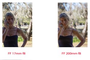

I have posted this illustration many times in similar discussions, one is with a 200mm lens and one is with a 17mm lens, shot from the same place the "compression" which everybody with any hint of a photography education knows as perspective, is the same.
Lens compression is a bullshit term used by people who don't know what they are talking about to describe a phenomena that visual artists have well understood for hundreds of years and is universally called perspective.

What on earth are you on about. This is a well known and well understood concept. Quit being pedantic and trying to change commonly accepted terms to suit your fancy. Has nothing to do with cropping to get the same fov or some BS. Its as if you have never taken a landscape shot in your life, but i know thats not the case, so are you just trolling or what. Telephoto compression is not some new thing the kids are on about. You learn about it in art class for gods sake, when drawing perspective.
all you did was crop your 17mm to 200mm. do you not understand crop factor either? what gives?
This discussion reminds me of people calling ammo magazines clips. Totally derails firearms discussions and doesn't really matter as long as the firearm doesn't jam and you make the shot.
I will admit that I have used a similar cropped picture many years ago when I was teaching a basic photography course to demonstrate perspective but some still called it compression and it didn't matter if they made the shot.

Is that because my eyes are about 50mm and the elk looks 4x closer using the 200mm zoom?
