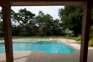

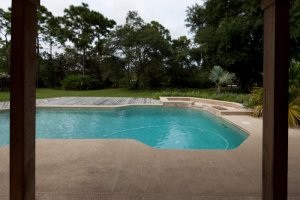

So I dug up the tests I did. It is important to understand what is going on here so forgive me if I don't explain it well.
Image 1: I set the camera up with a level to be perpendicular to the ground and parallel to the posts, through the viewfinder everything was straight and level. I then applied full forward tilt of 8º on the lens only and did nothing else, that is the first image, as you can see the posts lean in a lot at the bottom, this is the "characteristic" of retrofocus tilt lenses, and it kind of sucks.
Image 2: I then looked through the viewfinder and tilted the whole camera back until I had the posts parallel again and took image two.
Image 3: I then took a picture of the camera illustrating how far back you have to tilt to get the posts parallel again.
Now this looks pretty dramatic, but as I pointed out, in actual shooting situations the need for extreme tilt and close quarters parallel lines is not something I have encountered, though it does limit tilt use for interiors if you are using very short J distances. However for normal 40"-48" height interior shots it is no issue as the tilt required by a 17mm lens at that distance is >1º if you are even using tilt.
Hope this helps.

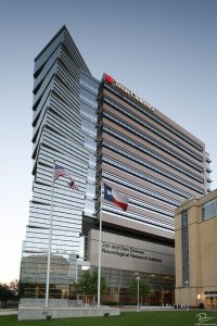

I was able to go out after a bout of rain followed by bout of fever. Wasn't able to do much other than take my first shifted image of a high-rise. Nothing special... at all. But I am taking baby steps.
Hand held, 1/25s, 1/100, no tilt.
Wonder if it needed less stretching...

sagittariansrock, nice building, the sort of thing the 17 was made for.

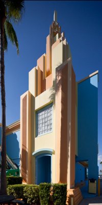

One thing I do with big shifts is resize on the shifted axis but not on the other axis, many might say it is sacrilege and you lose IQ, but the truth is the building gets compressed in the shifted axis, I normally resample 10% - 25% or so more to give the building back its height and haven't had any real issue with IQ.
Here is another test I did with mine when I got it, the first shot is full shift and as shot, the second has been resampled on the shifted axis only, in this case an extreme 30%, that is what it took to get the building back to the actual proportions of the real life structure. But I was very close and used max shift, normally not so much resampling is needed and you need to strike a better balance between IQ and actual proportions.

Thanks, there are some interesting buildings in the Texas Medical Center.
I see what you are saying- the building gets squished in the shifted axis. How would you stretch it in LR?

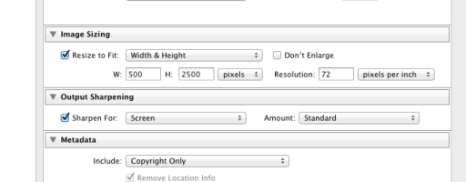

"How would you stretch it in LR?"
You would have to use the Export dialog box, the bit about Image Size, you can change to resample, you can then set it to reimport the new file.
