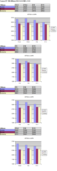

Testing continues to amaze me. ePhotozine has just published their measured mtfs of the 100-400 II on the 5DIII and have quite incredibly at 400mm the following, with a sharp increase at f/8 and f/5.6, f/11 and f/16 the same Top). Do abrupt peaks like that rea;lly happen (top graph). On the other hand, photozone.de have a smooth transition with f number (bottom), and TDP has f5.6 ~ f/8 and f/5.6 clearly better than f/16
http://www.the-digital-picture.com/Reviews/ISO-12233-Sample-Crops.aspx?Lens=972&Camera=453&Sample=0&FLI=4&API=1&LensComp=972&CameraComp=453&SampleComp=0&FLIComp=4&APIComp=3
Perplexed.

I don't think so. It simply looks inconsistent that there is a radical jump in MTF from f/5.6 to f/8 and then back again. Also the flat response from centre to edge looks very odd - even Canon's MTFs show the centre best and the edges worse. If I had made measurements like these in one of my experiments, I would be checking them.
