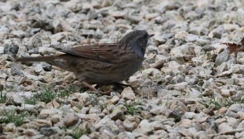

This I do not like:
Its a large JPEG straight out of the Camera, just cropped to keep the file size small. Pretty low light, the stones are properly exposed I think. Focus seems about OK, on the pebbles, but there is no detail whatsoever on the bird. OK, the bird is darker so somewhat underexposed. But there is just no information at all in the dark areas of the bird, just brown mush.
My error? Just not ETTR enough?
Cheers Brian

bjd said:
This I do not like:
Cheers Brian
I wonder if this is an in-camera thing concerning how much NR is applied to a L jpg, I haven't changed any such settings, and maybe the default is very aggressive? Couldn't find anything like that.
Cheers Brian

I don't know if this was meant as a joke or not, but the bird is clearly not sharp because he moved his body too fast for the shutter speed that you were using.
I would say that your camera back focused by approximately 6-10cm. at 400mm, F13 and 5.7m distance to subject thats all the DoF you have available. ( 5cm in front and 5cm behind the subject. ). Camera shake is also likely as another factor..
as ph0t0 points out:
you are shooting at f/13, 1/750s, iso 6400 and the bird is moving so there is motion blur.
at least half of the bird photos you take are going to look like that unless you are shooting a really fast shutter speed. its okay to use a relatively slow shutter speed but you are going to have to take more shots and sort through them.

1/750 should be fast enough for a bird that's not flying.
But in this instance, the camera either hasn't locked onto the bird for focus or the camera plus lens need some TLC courtesy of AFMA.
those little birds are really twitchy. 1/750 or even 1/250 is fine if they are not moving but if they are you need a really fast shutter speed to freeze them.
To further ask, is this joke or deliberate troll, since the camera does not have 1/750 setting. I have my camera here, after 640 the next is 800.
So was it shot at e.h. 1/250, and he manually fixed the exif to 750, and then wanted to troll/bash how bad the camera is? Or does 1/800 report as 750 for some reason?
And the picture is obviously motion blur. If you shoot birds and don't figure out that from the picture, you should go buy yourself T2i with kit lens. That'll fit the bird pictures better.
You can get 1/750 sec, just select 1/2 stop increments for adjustment rather than 1/3 stop increments. It is under custom functions and has been for many years on some models.
For those interested the EXIF is 5D MkIV, 100-400 MkII. 400mm, f13, 1/750 sec, 6400iso. Subject focused at 5.7m.
If bjd did what they said and just cropped to keep the file size down then below is a rescaled image to show the actual crop.
