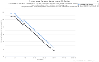

The key point that you're missing, and you're not alone missing it, is analogous to being unable to see the forest for the trees. It's true that at the level of the individual pixel, a larger pixel will have lower noise. But at the level of the full image, that tiny difference is completely overshadowed by the difference in sensor area. Claff doesn't show crop mode data on the read noise plots, because those are pixel-driven and cropping doesn't matter. But he does show crop mode on the DR plots, and in low light the DR is driven mainly by read noise.
You can easily see the effect of the higher noise floor with a smaller sensor on DR when cropping an image but keeping everything else about the pixels the same, by comparing the R5II to the crop-mode R5II:

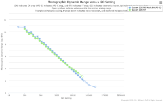

Or if you prefer to look at it another way, compare the same sensor sizes with very different pixel sizes, e.g. the R7 vs. the R6II in crop mode, where if you're correct the noise from the much larger pixels would be lower and the DR would be higher. Is it?

You can measurebate a single pixel until the full well overflows, it doesn't change the fact that for a picture it's the sensor area that determines the image noise, not the number of pixels that sensor area comprises.
As I stated earlier, it's apparent that you don't really understand the relevant principles. Whether you learn about them or continue in ignorance is up to you.
