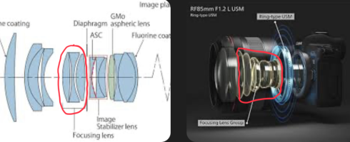

Many of the newer lens designs have two separate focusing groups, typically driven by either two separate Nano USM or one each of VCM and Nano USM. The RF 14/1.4L has two VCM motors, though I think that's the only lens so far with that configuration.
Having one big, heavy focusing group necessitated Ring USM to move it fast enough. Even then, sometimes that wasn't very fast – like with the EF 85/1.2L (I and II), where the 'focusing group' was all of the glass in the lens except the thin rear element. One reason the RF 85/1.2L focuses much faster is that the focusing group is smaller, only 7 of the 13 elements and not including the two largest ones in front, but it still needs Ring USM to move it.

It seems that the RF 85/1.4L VCM is also VCM-only, without a Nano USM motor. Several online reviews state that it has both, but I can’t find anything from Canon saying anything other than VCM. The lens appears to have only a single focusing group, whereas lenses with VCM + Nano USM or Dual Nano USM have two focusing groups (one floating).
Maybe a dumb question, but would it be impossible for Canon to take the RF 50mm F1.2L (or the 85mm) USM and "just" replace the USM-motor with a VCM style motor? or is the motor inside a lens so composed that a total redesign of everything is necessary?
I suspect a redesign would be needed, for either a smaller focusing group or two focusing groups. I believe Ring USM is still more powerful. Compare the focusing group of the RF 85/1.4L VCM (3 elements) with that of the RF 85/1.2L (7 elements), for example.
