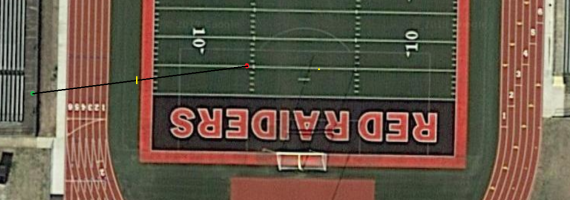

Good shot! But on the technical side, 200mm and crop sensor = 320mm FF equivalent which is even more sensitive. 1/800s at 320mm is basically the same as 1/500s at 200mm, so in fact you're kinda proving the point that 1/500s is enough at 200mm :)
In terms of the blur, all what matters is the angular speed. Say a 100m sprinter does roughly 10m a second, shooting at 1/500s from the side when he's moving perpendicularly to your line of sight, he'll pass 2cm in 1/500s, so it's a bit too much. But even 1/2000s won't be enough (he'll make 0.5cm in 1/2000s).
However if you shoot say at 1/500s and 15 degrees along his movement direction, 2cm turn into 2 * sin( 15 degrees ) = 0.51 cm, as if you were shooting at 1/2000s in the first example. So changing the angle from 90 to 15 degrees is like adding 2 stops of freedom.
Anyway, whatever the speed is, panning helps compensate that, but a good IS will help you with panning. Panning handheld without IS isn't that efficient.
There are two ways of looking at that. It is true that the image is cropped, but if I were standing closer (it's about half as far from the sideline where I would normally have been to where he was on the field than it was from where I was standing), then I would have had to zoom out a bit to make the athlete the same size in the image, because he would have been a larger angular size from the shorter distance, and thus the same amount of movement would have been more blurry than from further away. Measuring it on google earth the sideline is roughly halfway between where I was standing when I took this shot and the near hash marks near where he was running. The field has been replaced with an artificial rug since I took that shot, but I do not think any of the field lines moved much, if any. The stands were not altered at all.
The red dot on the field is the runner, the green dot is where I was standing, the yellow line is where we're allowed to be on the sideline.
