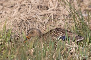

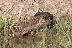

The kind of picture I'd like Eye AF to catch is like the attachments.
Because DoF is quite shallow (because it's 360mm and only a few feet away), focus can be unforgiving. Also, it is quite busy with all the tall grasses.
I can't speak for other bodies, but on 80D/6DII, it's pretty hopeless -- often, AF just catches the tall grasses -- and I end up using manual focus.
This type of AF/MF situation is not uncommon for me if I'm trying to get to eye level to wildlife, like on the first one.
The 6DII has Spot AF, doesn't it? Like the 7D2 and up but unlike poor 80D :(
Sharlin said:
Indeed it does -- and I wish 80D did too :( But it works poorly when there's stuff like grass, because often, the grass gets in the spot :) Plus, the critter's eye doesn't stay very still, and trying to pick an AF point that will work on an animal that's bobbing around unpredictably is not reliable.
It's easier to MF, and then breathe the focus ring slightly as I snap a few photos; some of then will be in focus. But what ends up happening is I take 20 pictures of an animal, to reduce it down to 4 that I'm happy with.
