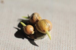

I took this quick picture with a nifty fifty using 12mm Kenko extension tube on a crop camera to show you what magnification you can get. It is a nickel in case that is not obvious. Only PP was to scale it down for the web.
For occasional close ups the tubes will be much better choice then a dedicated macro lens since you can use any of your lenses. And if you put something like the nifty fifty then you can have the tubs attached to it all the time.
