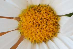

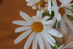

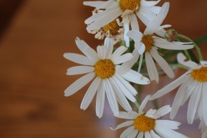

Here are some comparison shots:
50mm 2.5 @ f8 and ISO 100. I used f8 as it appeared that the OP used something similar in the ring shots. f8 provides sufficient depth of field and a soft background. All focused on the centre of the same flower. Live view (so mirror locked up) and 2 sec self-timer.
Large fine, downsized to 1020 pixels high (I have the original files)
1. 1.5 ft (min focus of 50mm f1.4
2. 1.5 ft with Canon 250D close up lens
3. 0.89 ft (27cm) to give similar magnification (1:3)
4. 0.75ft (23cm) 1:2
5. Focused at infinity with 25mm extension tube
6. Set at similar magnification 1:2 with life size converter.
The last two are in the next post.
Here 1000 pixel vertical crops of the original images.
First the two photos at 1:3. 50mm focused at 1.5 ft with 250D, then 50mm focused at 0.89 ft (no close up lens)
I note that the second photo is not focused at the same point as the first (bit of a rush over my lunchbreak!).
Now the three photos at 1:3
50 focused to 1:2
50 focused at infinity with EF25mm extension tube
50 focused at ininity with lifesize converter.

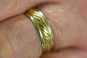

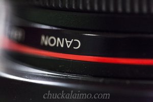

been rethinking things....my 24-70v1...for some reason I have black listed this lens as the worst in my kit, leave it at home, and yeah lets dump/sell it... Why?????? when I got my primes, I fell in love and wanted to use them...cause they rock...but, that 24-70...it's not nearly as bad as I had thought, and ---it can actually get pretty close, not macro close but close ---here's 2 just snapped... It was shot in mRAW (so if i bumped it to full RAW it would be even better) so keep that in mind, first one is uncropped, as close as i can get with the 24-70, second is a heavy crop...
So, maybe the answer in the hear and now is right in my bag! I may still snag a tube, just to see what they're like. But, I think I may be able to get by just fine with existing gear...which would give me the flexibility to snag a dedicated macro lens down the line.
TY for all the great advice everyone!!!!

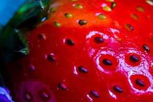

I can't afford a true macro right now, so this is what I use for now: 55mm of cheap Chinese tubes (6$) and 30$ russian Industar 50-2 f3.5 (which is the smallest 50 I've ever seen) and chiped m42-EOS adapter (9$).
~100% crop
shot at f16 with of camera flash, iso 200. Basic sharpening and PP in LR.
Don't know how it compares with real macro lens but for the price seems like a great deal to me.
