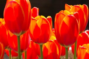

Will do. In the meantime, here is one taken with the T3i and 100 2.8L wide open. The 5D MKII images don't even come close to this.

Oooooooooooo! Really nice.
