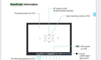

Here's the 1ds3:
And here's the 5d2:
Screenshot - 08252023 - 06:36:11 PM.png
And the 6D looks the same:

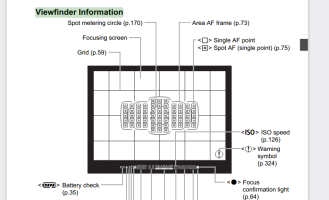

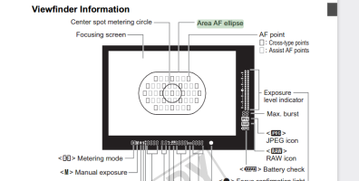

But the 1dx introduces the grid and also the floating AF icon in the corner:
Screenshot - 08252023 - 06:38:15 PM.png
Obviously, the grid is something you can turn on and off, so it's LCD.
And the 5d3 looks similar (with a floating warning symbol in the lower right, and a grid):
The manuals on the two later models explain how you can toggle these features on and off (like the grid, or the outlines of the AF area).
In the older models, you can't turn the circle or oval off, so that must mean they are etched and not LCD.
