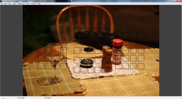

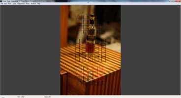

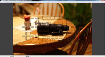

luckydude said:
Hey, ease up a bit, I'm just trying to learn here. And I'm not quite the idiot you think I am, I shoot sports and it's almost always center point only, I get good shots, as good as the pros at the tournaments I've gone to.
Perhaps you can explain how these defined set of parameters choose what they choose. Why does it sometimes choose what is the background, ignoring a decent foreground? Why does it sometimes choose stuff off to the side and other times not?
Did you look at those pictures and can you explain why it choose what it did?
Am I the only one scratching my head over that? For the record, the 5DIII does not do that, the 7DI did not do that, my 20D and 40D and T4i did not do that. But I'm sure the problem is me and the camera is perfect and all those other bodies just happened to do a better job.
Did you have iTR metering enabled for this? If you look at which AF points are selected in the shots you've provided you can see that the camera is always selecting the high contrast target closest to the camera which is exactly what the 5D3/7D1/70D will do as well as the 1DX if you turn iTR off. With iTR turned on, the camera should try to find faces in the frame to lock onto first and then go for the closest high contrast target. As others have said though, for this kind of scenario large area AF mode in AI Servo mode with iTR turned off is probably the worst mode you could have picked. In order of preference, I would have chosen Spot AF/Single Shot --> Single Point/Single Shot --> 65 point/Single Shot/iTR. Also, iTR only looks for faces in single shot mode; in Servo mode it samples the color underneath the "seed" AF point and then uses that information to help track the subject through the frame.
luckydude said:
FEBS said:
Please do read the 7d2 AF guide carefully for using all 65 points. There is mentioned in that guide that if one-shot is choosen the closest point of the 65 points will be used. In ai-servo mode however, focus starts with the manual selected af point And will then follow that point over the 65 different positions, dependentie on Itr additionele tracking info. Both methodes are very usefull, however they different ferm the current p&s that have auto face recognition which the 7d2 does NOT have. The 7d2 Has a color And face tracking system, but that's different from p&s
Thanks, will do. Is the all points mode in the 7DII a departure from the 5DIII and other earlier bodies?
I remember discussions here about how the camera will decide where to start and there is supposedly logic in there to prevent (as was shown) an fencepost grabbing the focus when the main picture is beyond that.
The 5diii And the 1dx behave the same in all points AF in combination with ai-servo. The 5diii has however a less intelligent tracking system compared to 1dx And 7d2.
To be honnest I never use all points on the any camera. I like to be in control by using at single point with most of the time 4 point expansion. Only for birds against the sky, And when I have trouble to track a bird, then I use zone or all af points.
In the beginning I also had problems with such a complex af system. However, on the 5d3 after a lot of testing And Reading I found my wat. I never had afterwards any problem with the 1dx nor the 7d2 recently, caused by similar af system And all the efforts I made in the past. Sorry, but all focus points is much more complex as it seems And in no way to compare with the all focus points of a p&s.
