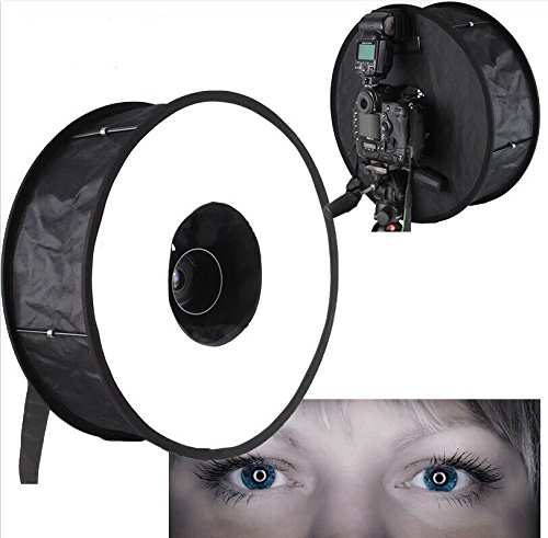

I recently purchased a large reflector, I have not had time to try it out for macro use, its throw away cheap.
I admit its klutzy, so I do not have high hopes for it as far as macros.
http://www.amazon.com/Fomito-Universal-Collapsible-Magnetic-Speedlight/dp/B016CY5FC0?ie=UTF8&psc=1&redirect=true&ref_=oh_aui_detailpage_o07_s00

That reflector looks more like a beauty dish than a macro flash, and won't do for what I use it for. I shoot 1 cm to 1 mm flowers and shells. At low end with Zeiss 100 MP, then MP-E 65, then stereomicroscope, then compound microscope, then scanning electron microscope. On all except SEM, with plenty of z-stacking. Not infrequently I bounce flash off card board, or ceramic bowl, therefore, heads need to be freely movable and detachable.
That is too cool! If you use it for portraits please let me know what you think of it. The catchlights are very nice I think.
I use it for portraits and I like it a lot. The best part is when folded it takes a small amount of room, so you can always have it with you.
The catch light has a small break at the top, I fix that in post.
