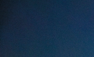

Here's the upper left corner of that pushed, uncropped image:
So, ISO 16000 pushed to ISO 64,000 plus probably >2 stops more pushing in the corners so that's something north of ISO 256,000. Where are these 'artifacts that look like a lattice, moire and so on' that are caused by ‘squeezing in and stretching out the noise‘ that I am supposed to see and that are supposed to render my images unusable?
I have certainly introduced artifacts into my work playing around with Photoshop and Affinity Photo. But as mentioned above I have not reproduced this issue with my stable and DLO. I have to assume zardoz reports a real experience. @zardoz, can you elaborate on the scenario?
But you've chosen a corner with pretty much no detail. Can you show a bottom one? Assuming it's not too dark and some detail is indeed visible
I chose a corner with no details because the point being made was that the noise characteristic was problematic and not 'uniform and consistent', and an area of the image lacking detail is the best place to see noise artifacts, if there are any to be seen.
