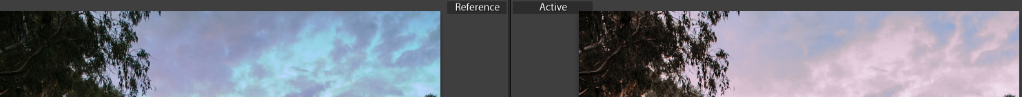

I use Lightroom for HDR merge, but the colour cast is evident before the merge, check the file produced by DPRSplit on the left and the normal CR2 on the right. The cast is actually greenish-blueish, but anyway
(some LR sliders where tweaked on the left and on the right, I didn't bother to reset the sliders, the point is the cast is always there, you can't recover).
As above, a couple of times DPRSplit worked ok for me, but I didn't bother to figure out what conditions make it produce the colour cast sometimes. It's just unreliable and can't be used as a part of normal workflow - e.g. I wouldn't recommend to deliberately overexpose relying on DPRSplit recovery.

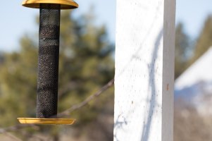

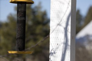

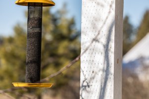

I did try DPR split long ago, it required DNG files and a lot of hassle, but it worked to provide more DR.
Here are 3 files, a jpeg created from the original raw, notice the detail at the top of the white post, and then a helicon merge image and a photomatix merge image.
I also tried Lightroom merge, but the result was so poor I must have deleted it.
Notice that the software does have different results you could tweak them to look the same, but I chose not to.
