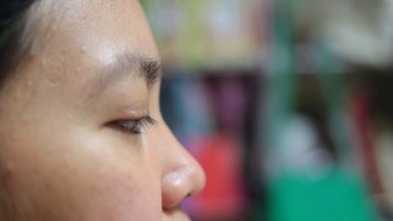

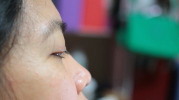

Thanks guys.
I knew it there must be something behind the big glass.
The culprit, I was doing AFMA wrong. My target was wrong and I read somewhere that subject must be far enough.
So I download starburst chart and follow Neuro's post back in 2011.
See final AF results below (I resize the chart to fit A4, which was wrong cos AF box does not detect center starburst) - good enough
Now its time to compose some shots. :)
. AF Test
. 35mm f2 IS crop
. 40mm crop
