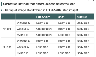

In the B&H Q&A panel Rudy Winston from Canon said the following:
  • The stops are measured by the CIPA standard
  • EF and RF non-IS lenses will get a menu entry for IBIS
  • EF and RF IS lenses won’t get a menu entry, IBIS is controlled by the IS switch on the lens
  • EF IS will work ‘simultaneously’ with IBIS
  • RF IS will work ‘in conjunction’ with IBIS
One of the Canon USA promo clips had a disclaimer saying any IS lens announced before July 9th will need a firmware update.
My interpretation is that for EF IS lenses, IBIS will only do rotation compensation, not shake compensation. For some select EF lenses you’ll get a firmware update to enable full IBIS, my guess would be the 2018 400mm and 600mm, since those seem to have RF style electronics already.
I hope the 100mm macro also gets a firmware update and full IBIS :)

More Rudy talking about IBIS at the 29:11 mark. His remarks about "low speed and video" stabilization on EF IS lenses seem to confirm my suspicion that it won't do shake correction on those, only rotation. The support for low frequency things like breathing is a nice extra :)
You also can find Canon staff making the opposite claim. See after 2:50 in this:
If my English isn't deceiving me here, he says IBIS corrects for horizontal and vertical movement as well as roll when using an IS EF lens.
I am personally trying to keep away from any further coverage. At this point it seems to me that there is too much info floating around, that can't be verified yet. And it is very hard to see what claims people are making is based on what.
