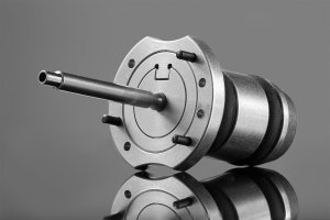

On another note, product photography is not my forte per say but I found myself with a local client who manufactures SMT vacuum nozzles. (Absolute tiny things.) Here is a photo I used done with einsteins + 36" stripboxs+reflectors. I would stay away from speedlites as they just don't have the Mods to make your life easier when shooting tiny products.
I recommend visiting photigy.com for some serious schooling on product photography and its free.
