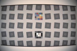

Sounds like Canon chose a very similar set of compromises to Nikon's 14-30 f4. In Nikon's case the corrections are built in and unable to be turned off even in lightroom, so I'd say at least having the option to turn them off is nice for scenes that might not require it. Below (via photographylife.com) is the raw image uncorrected from the 14-30 also at 14 and it looks very similar. Given the Canon goes out to 35, has built in IS and appears at least as sharp if not more so than the Nikon according to TDP, I'd say it looks like a great option. When the Nikon came out everyone said how great it was that there was a small and light 14mm capable zoom for mirrorless and now the Canon equivalent comes out and people are complaining it isn't as good as the Sigma 14-24 that has a shorter range, no IS and is literally double the weight.
