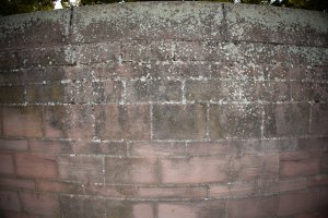

Here's a quick shot with an RP using the RF 16mm (processed in DPP).
I'm just getting started with PS Elements so I could easily be doing something wrong, but below are two lower right corner areas from the same pic. The first is a JPG from Canon DPP (which automatically applies distortion correction). The second is of the approximately the same area from Photoshop Elements (which was uncorrected). I assume the brightness/contrast/color differences are from the different JPG engines. I don't see much difference in sharpness, but I'll leave that to others.
DPP (corrected)
Photoshop Elements (uncorrected)
Even though the 100% crops are of the same area, the DPP crop is 600x600 pixels, and the PSE crop is 433x433 pixels.
