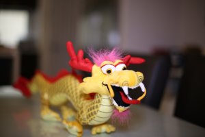

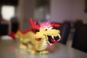

this was all shot tethered on a tripod
lit by an LED video light
focused via live view and tweeked on the eyeball of the dragon for peak focus
exposure was set to approximately +1 EV for all shots
Auto White balance
images are JPG straight from the camera
wickidwombat said:
viggo how much sharpening are you adding to those images in LR?
As stated I added a bit too much to really emphasize the focal point. Redid everything today and it seems the small "macro target" in FoCal isn't working with the 50 at mfd. and infinity I simply couldn't do in FoCal. But now it looks much better. I'm not 100% ready to say it works, but it's much better. The Sigma doesn't seem to like Ai Servo, so I more often tap the button that switch to One Shot and it does the trick. It's slowly turning into a winner here.
