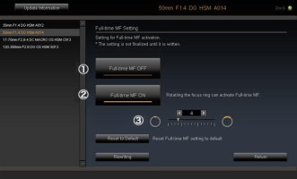

"Interesting is that, according to the owner's manual, "You can [snip] adjust the amount of focus ring rotation to operate Full-time MF function." via the dock.".
I'm not sure I understand well this sentence (english is not my native language). Does this means that it would be possible to have, for instance, a 270° focus throw instead of 90° in manual focus? Help would be appreciated, thanks! :)
Ok, I think I get it now.
Here's what it says in the manual: "It is possible to adjust the timing to operate Full-time MF function." And it provides the following image.
I think it means you can change the amount by which the focusing ring has to be turned to trigger the MF override. So, let's say your fingers accidentally touch the focusing ring, that will not change the focus.
