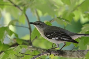

Don, now that is very acceptable. What is the difference between this shot and the previous?
I think it is a AF problem. I had 4 helper points enabled on that shot and rather than pick the chest of the bird, where the central point was, it picked one of the helper spots where the top of the stick is. it could be that the feather pattern on the chest was poor to get AF from.....
Don Haines said:
There is a comment on the dpr site from someone who had two bad copies of the Tamron 150-600mm that were hazy in the areas with fine details.
https://www.dpreview.com/forums/post/58505868
Both your shots were in focus, as seen by sharp beaks and claws.

Maybe camera shake, combined with strong cropping?

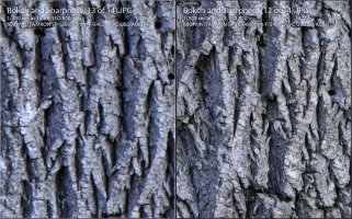

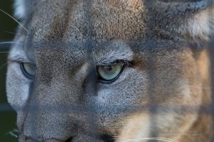

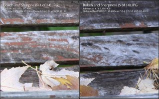

At first I felt the same as the mood on this thread, but that was when I had only tested the lenses near minimum focus distance (which I suspect is what has been done in these tests). When at more normal shooting distances for lenses like this (25-50 feet+), there is a clear advantage for the G2 in contrast and resolution.
The one downside I see is that light transmission is better in the V1 lens (they added an element to the optical formula of the G2). Color rendering is completely different between the two lenses, too. Better bokeh on the G2. Handling is infinitely better in so many ways.
It's a solid upgrade, but if someone is looking for a night and day improvement, they had better open their wallets and move to the one of the super teles.
The cougar is wide open - 600mm, f/6.3. The focus is not calibrated, as I met the Tamron rep and got the lenses right before going to shoot.
