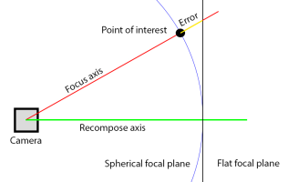

You still fail to understand. Many of those lenses *are* sharper in the corners and on the edges than an ignorant perusal of the image of a flat test chart made when the lens is focused at the center of the test chart would lead an uninformed viewer to believe.
If one is concerned with focusing a subject on the edge of the field of view, why would one focus the center of the lens? Focus the lens so that the subject at the edge of the FoV is in sharpest focus. See how easy that was?
Further, if one is forced to use focus and recompose, a lens with field curvature will introduce *less* error than a lens highly corrected for flat field will.
Further, if one is forced to use focus and recompose...
Right on the first one but
I was never talking about "focus and recompose".
