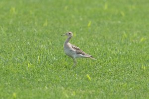

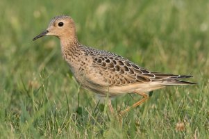

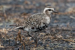

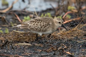

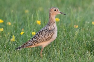

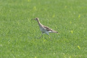

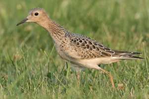

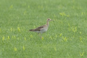

I've been out of it lately, too many pictures and no editing!!! Shorebird migration in my area was decent this year, with several rare birds coming through and hanging out for awhile. All taken with 7D mkll / EF 600 F4 ll / 1.4x lll.
Jeremy
Buff-breasted Sandpiper
Upland Sandpiper
