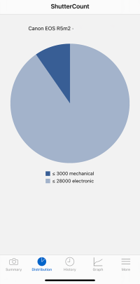

Thanks. For the R5ii shuttercount.net says the shutter count not supported. For the R5 it gives just the total number and not whether ES or MS.

The ‘About’ information has Shuttercount mobile version 7.0 (771). The Live view pack is installed. If I remember correctly I paid about 5 Euro (a long time ago). The app has a 7 Euro plus pack, which enables additional reports like graphs and history. I did not buy the plus pack.
The answer to the original post is that Canon does write shutter count to the EXIF, but only a few users managed to decode and extract it for specific models (and the EXIFTool software was updated to read out this information).
