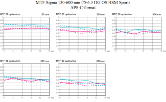

Just look at the MTF charts for the Sigma Sport in the link I posted.
I had. They are, potentially, troubling. But, they reminded me of:
[list type=decimal]
[*]Quotes that I have read over time that using imatest and other software for long focal lengths is problematic
[*]How little stock I put in single reviews from websites I've never heard of before.
[*]How while I do look at test results, I am more swayed by actual images.
[/list]
Also, part of the dip is going from 20 cycles/mm for FF to 30 cycles/mm for crop. Granted, some great lenses did not see much of a drop (70-200 II, 300 f/2.8 II). So, it is possible that high density sensors may expose a flaw with the 150-600S. I believe we are both fans of TDP, so lets see what happens when Bryan posts his results with the 7DII (assuming he is going to do this). If he is also showing an atypical drop off in IQ, that would carry more weight with me.
BTW...he already has observed a reasonable drop off from FF to APS-C with the other lenses, including the 100-400 II.
http://www.the-digital-picture.com/Reviews/ISO-12233-Sample-Crops.aspx?Lens=972&Camera=453&Sample=0&FLI=5&API=2&LensComp=972&CameraComp=963&SampleComp=0&FLIComp=5&APIComp=2
But...at the end of the day, even if the results hold up, that really isn't the point, at least to me. The point is "how do you get to 600 mm cost effectively." It isn't as if I am trying to have the 150-600S win some sort of prize for "best lens ever." It is a tool and what really matters is comparisons to lenses in the same price range that serve the same function. Thus far, the IQ from TDP for FF shows 600 mm on the Sigma and 560 mm on the 100-400 II to be essentially even. Thus, other factors when into the decision on which lens is selected. Could it be that result changes on a crop body? We'll see. Hopefully Bryan posts results with the 7DII and Sigma.
