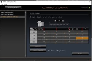

to demonstarate what exactly I was talking about I attached my Sigma 120 300 F2.8 Sports calibration table. it is quite self-explanatory though. as you can note there is no a single universal AFMA value that is good for all calibration points (distances to target) and focal lengths. On contrary AFMA correction amount required (variation) from MFD to infinity are quite extreme. from extreme front focusing at MFD (1.5-2.5m) to extrme back focusing at Infinity (50m).
As you can see, if in camera AFMA settings set to correct lens at MFD, then at infinity lens will be out of tune by -25 AFMA point. this is very substantial back focusing. I mean massive one.
I spoke with Sigma service on numerous ocasions and all they can offer is in lens AFMA calibration at x50 and not at entire lens range.
and no, my camera is not faulty or out of tune. all my Canon and Tamron lenses are almost perfect AFMA wise out of the box and across entire range from MFD to infinity. I own 2 Canon 6D bodies and get similar AFMA numbers for the Cam1 and Cam 2.
and no, this lens is not a bad copy, it is insanely sharp when properly calibrated. my other Sigma Art lenses behave in a similar manner. not to that extreme levels like my longest telephoto but AFMA variations from -10 to +10 MFD to Infinity seems to be a norm for the modern Sigma glass.
