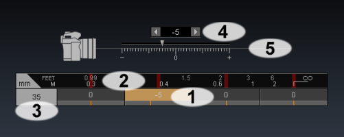

Having researched the Sigma USB dock, I thought that it allowed AFMA calibration of the lens at up to 4 different distances. I thought that this could solve the problem. BUT on trying my lens in the dock it appears that it is not possible for the user to select what these distances are ?!
In the case of my 35 mm lens this will make the dock calibration process of little benefit. If for example I use optimization pro to set AFMA at infinity and at 0.75 M then the calibration will be correct at these distances and off in between 1 and 4 metres. I am struggling to understand the logic of optimization pro since with a 35 mm lens if you are using it for photographing people then you are going to need to work within this distance range. Why have three of the four AFMA distances for this lens at less than 1 metre when any close up/macro type work is likely to use MF anyway ?
