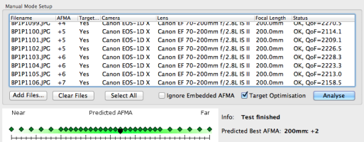

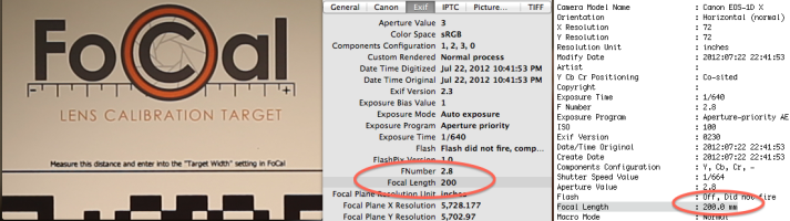

Mine reports 200mm in the EXIF as seen in Mac OS X Preview, Exiftool via the Terminal, and in Reikan FoCal. When I set it to 70mm or 135mm, those values are reported in the EXIF, too.
