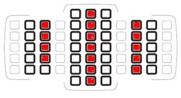

anyway i did some testing with my 5Dmk3 and the yongnuo ST-E2 copy on the weekend
and which it fires the flash the timing does seem off and you just get black images
then i decided to just try it for AF assist purposes
... in a dark room
and it works really well. with a couple of factors to note
the grid it projects might not necessarily line up with the af point however it can be rotated to make the grid line up (it doesnt take much rotation)
the AF response was nice and snappy MUCH MUCH faster than not having it
in future if shooting low ambient light i will definately still use this for AF assist purposes
I have attached an image showing which AF points work (coloured in red)
not sure why the bottom left one wouldnt work but I am pretty happy with those points being useable in almost zero light
hope this helps anyone else wondering about this

dunno i've only got the knock off but its really really fast for very low light shooting where I've found the AF speed pretty sluggish, granted it will actually achieve focus where the 5Dmk2 would previously get nothing
also being lighter and smaller than a flash is nice if you only want AF assist, I have also found the AF assist from the 580 ex II to not be as effective as the little yongnuo beasty

I was in my home theatre aiming at the blank white projector screen so absolutely now way of geting focus lock even in good light without AF assist, it was almost totally dark, i was standing probably about 8m away from the screen so its pretty powerfull
