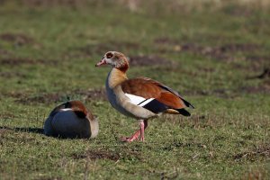

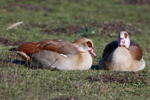

Here are two shots of Egyptian geese at about 20-30m. The stacked TCs required manual focus which I did through the viewfinder, rather quickly, resting the lens on the ledge of a hide. The full shots are reduced to 1200x800, the crops of the heads are 100%. The goose standing is done with just the 2xTC attached. The sitting goose with the 1.4x + 2x.
Both are wide open (f/5.6 with 2x, f/8 with 1.4x+2x), iso 640 and 1/3200 or 1/1000s.

The AF is so limited for the stack that I used manual focussing through the viewfinder so AFMA doesn't come into it.
When I got good focus, the results were very acceptable. Using a tripod for a static subject, for moon shots etc, I think the stacked TCs could give an advantage. I got a reasonable shot of a bittern in reeds at the very limits of resolution which was at least as good as just using the 2xTC. But, the whole rig is too cumbersome for my hand held shots, which is what I want to do. And the loss of AF is a killer.
