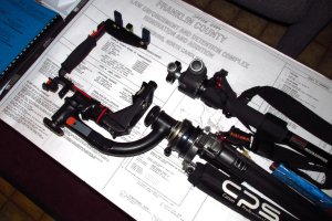

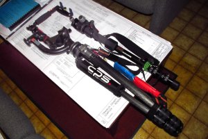

A few things to go with it would help.
A good solid monopod, it makes it easier to carry and hold.
A Gimbal type head like Wimberley's WH-200, RRS makes a nice one as well for tripod work.
Tripod legs sturdy enough to support this.
For my use I would say 30% of my shots are hand held, 40% on a monopod and the rest off a tripod.
For monopod and hand held work, even with the improved IS of the new 600mm, shutter speed is your friend with this lens. The more shutter speed you can get the better pictures you will be taking.
The lens will be very sharp wide open, because of the light requirement for fast shutter speeds you will find yourself shooting close to or at F/4 quit a bit.
