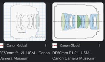

what about normal lenses? let's say, how would they calculate the dream lens front element? (50mm f0.95).
Thanks, great explanation!
‘Normal’ focal length lens designs are often relatively symmetrical, such that the entrance and exit pupils are very close to each other and near the physical iris diaphragm. That’s true for both the older double gauss designs like the EF 50/1.2 and the newer, more complicated designs like the RF 50/1.2.
The front element size is mainly determined by the degree to which designers want to reduce aberrations.
