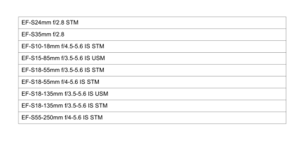

Has anyone seen the attainable framerates by various adapted EF lenses? If it exists I haven't seen it. Interested mostly for my 100-400 II and 70-200/2.8.
There is a page out of the manual for the R5 floating around in one of these threads that lists them all. I'm not sure which one it's in, but I'm pretty sure it came right out of the manual.
EDIT: It's page 896 of the R5 manual. All adapted lenses that can do 12FPS.
