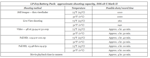

Hi Jack,
This may be of interest to you regarding battery consumption while shooting video -
http://learn.usa.canon.com/resources/articles/2016/eos1dx_mkii/eos1dx-mkii-battery.shtml
For immediate reference though -

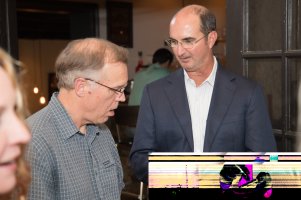

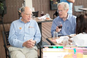

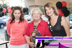

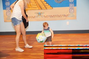

Is anyone but me having problems with RAW files on the new 1DX Mark II? I am getting these strange rectangles of garbage in the lower right hand corner at random. I have not been able to determine when this will happen. Canon support was of no use - they just said I could send the camera in if I want.
You can download RAW files here: https://www.dropbox.com/sh/as5ckrbveigaj3o/AACjwRe8IcI5Ug5CW_2ntmYHa?dl=0
What is peculiar is that the built in preview file is fine. It looks good on the back of the camera, even when you zoom in. You do see the problem on the camera if you go into RAW Processing to create a JPG. You don't have to DO anything, you just need to go into that menu option.
I see the garbage with Canon Professional, Lightroom and Capture One Pro.
I was shooting on a SanDisk 128GB Extreme Pro CFAST 2.0 card at the time.
Attaching some JPGs of what I am talking about.
Seriously, try a different card. At least one user has reported about a 10% failure rate based on a large purchase.
A number of users over at Photography On The Net are saying they have similar problems and tried various permutations of card/reader but some still get the issue.
Perhaps it could just be a firmware fix? No idea when we'll see the first "...in some situations users may experience the phenomenon...", which is Canon-speak for "hey guys, we screwed up but we all know digital cameras are complex, right? So download this patch and cross your fingers...".

Does it happen if you only use a cf card?
zim said:
This is reportedly only happening with CFast and not CF cards. I'm willing to bet a firmware update will cure this, but I'm keeping my eye on this problem before I take delivery of my new camera.

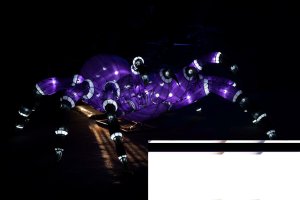

Shooting on a SanDisk 128GB Extreme Pro CFAST 2.0 card and have problems with lower right hand corner image in RAW. Recording both sJPegs and Raw to the CFAST Card. No problem with JPegs. Out of a thousand shots I've now got three Raw files with the lower right corner problem. Problem there when using Canon software and Adobe LightRoom and opening direct in photoshop via ACR.
I hate to say this, but I feel better seeing someone else with the EXACT same issue. I too have only seen this shooting to CFAST and I am using the same SanDisk 128GB Extreme Pro CFAST 2.0 card. Yesterday I did a shoot where I had the CFAST card in one slot and a Lexar 128GB regular CF card (1066x) in the other slot, and I setup the camera to write RAW files to both. Out of 166 shots, two were corrupted on the CFAST card. Those same files were fine on the Lexar CF card.
Prior to the shoot, I had even downloaded the Full Format and Refresh tool from Sandisk here http://kb.sandisk.com/app/answers/detail/a_id/17370/~/cfast-2.0-full-format-and-refresh-tool. I got NO errors during the format, the camera format or copying the files off the card.
PLEASE report this to Canon. Eventually they will have to acknowledge and hopefully fix the issue.
