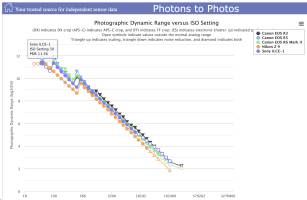

DR at low light is the least likely to be improved as sensors are pretty close to maximum quantum efficiency. There hasn't been an improvement for several years there and at high light levels (low iso) the top models are converging.
From photonstophotos
